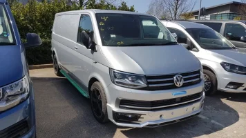

sitting there in the VW dealership getting ready for delivery . . . . . something just didn't look right?
We took pictures, a few videos, a few more pictures........ and kept on looking at it.
The more i looked at it, the more i wasn't sure . . . . .but just carried on for now.
We kept looking back at the flyer, then at the van and back again . . . . . it just didn't look the same.
For some reason in my minds eye it looked different . . . . and i wasn't sure i liked it.
It would appear that the color of the van made a massive impact on how the Factory splitter looked, and in my case i just wast happy with it.
Looking over the forum, other people had the same splitter and it was looking awesome . . . on black, grey, red and even white. But in silver i just wasn't feeling it.

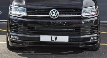

My van is fitted with the Sportline spoiler and I can’t make my mind up whether I like it or not.
From most angles I think it looks great, it’s just when you look at it from dead straight ahead that it doesn’t look right, it’s just far too wide.
I keep looking at the LV spoiler in the picture below. :cool:

I think you’ve got your wires crossed Sid.
My van has a Sportline bumper.
The picture that I posted is the Leighton Vans LV splitter which I prefer. :thumbsup:
