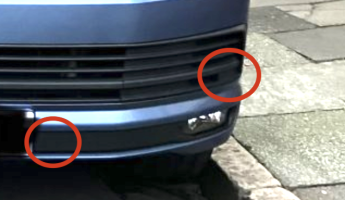

Daft question. Does anyone have a clue where front parking sensors are located on pic?
Xtrons head unit flagging randomly as if something in front of van (when there isn’t).
Was going to see if cleaning would help but in fact can’t even locate?!
I can’t see any on the pic. Has it had a new bumper and the sensors are dangling behind? Or is it an issue with the head unit (not heard of that one) thinking there are sensors when there aren’t?

Yeah no sensors to be seen, should be at the circled locations. Try to take a peek behind the bumper, if you don't have an engine undertray you could probably see the middle sensor locations from underneath by bending the bumper down a bit. Or maybe the side sensor locations from the wheel arch by bending the arch liner to see behind it.
