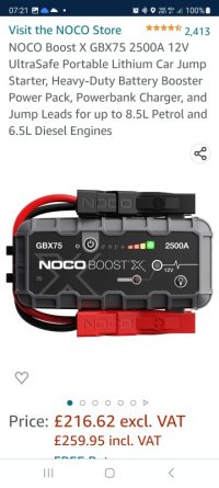

The gbx75 is the new model.
But, as you say it's £50 or £60 dearer. So in the example above I just listed the cheaper version but they are both awesome and will easily start T6 with ease.
(I have both versions, and the GB150, and now a GBX155 as well, and can vouch for them.)
