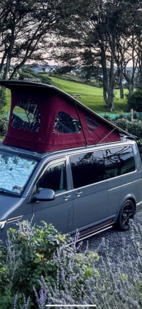

We haven’t got an awning rail. This is the pop top that we have, it’s a Lowlife Stealth poptop
