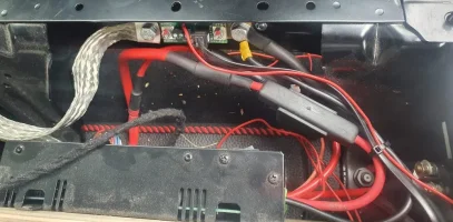

i put batteries back in today (FULLY charged) still only showing 75% soc on shunt meter (it showed 100% when i fitted it up around christmas with yours and GR help) i am getting power in from solar, was showing a 0.3 amp charge on shunt meter but nothing when engine running from dcdc charger - i am thinking this could be because batteries full? there was no drain showing on shunt with all off.

can you give specific model number and / or pics?

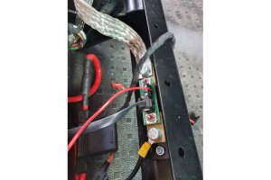

You don't still have the wire on the shunt like this do you?
I'm not sure of the current capacity of the braided strap but that thin wire on the other end with a crimp terminal on it is definitely not rated to 100A.
Will post voltronic manual tomorrow and a pic of shunt - but i did it just how you said before and it was all good, shunt is/was telling me exactly what was going in and out, even when inverter on.

From the pictures in #10 , it looks like its an NDS power service plus - not something I've come across before
