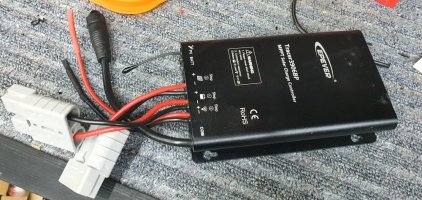

Hi everyone. I had a problem with my epever tracer an 10415. I followed the installation instruction very carefully I plugged the charger in my van to my lifepo4 battery and PV and turned it on. Everything was fine till I unplugged my RS 485 to connect the charger to my laptop to change the battery settings.
I heard a "stack" noise and the charger turned off and I wasn't able to turn it back on...
did everyone have the same issue?

My PV voltage is 36V and my lifePo4 voltage is 13.5...Voltages are correct... my MPPT is off so I have no readings from leds or display.
My MPPT is this one:

I connected my PV and my battery pack to their breakers and I first turned the Battery breaker on and then the PV breaker. At the beginning the mppt was working but was telling me that the battery pack voltage was low. (this is normal because the mppt battery setting was for SEALED batteries). At this point, I unplugged the RS 485 cable to switch to my RS485 to USB cable to connect my Laptop and I heard the "stack" noise I was talking.
I have a big 250A breaker for all my loads that I never turned on.
Anyways I'll make some pics today and post them...

It seems that maybe the solar MPPT has failed?
Dead?... Damaged internally?
If so I would recommend to swap out for a Victron MPPT 75/15 or 100/20 or 100/30
Guys... I don't know why but everything is fine now... I lived everything off for the night and yesterday mourning I just turned back on the PV and the mppt started working... I changed my batteries value from the laptop and ow everything works as it should.
Thanks a lot!!! to everybody...
