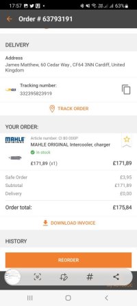

Just did mine this am. Mahle own Behr and made in same place .. really easy job.. 2016 E5 T6
@Pauly - I haven’t looked yet but the fault codes and symptoms I have seem to point to it being the intercooler. Assuming once I’ve checked and it is, does the Mahle unit come with the clips and o-rings or do these need ordering as well?
