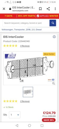

Update - issue has been diagnosed as the intercooler which has failed and requires replacing. Any ideas on part number and if the below would fit?

Any ideas of the above will fit or where I can a standard replacement?
Charge air cooler (CAAC engine) - VW part 7E0 145 804 B
So could I pick up one from a Motor Factors or somewhere like Euro Car Parts?
Well, there is always risk of incompatibility when using after-market parts. I would confirm the compatibility with the seller.
E.g. the Eurocarparts part you linked earlier mentions only MY16 2.0 diesel - not specifying exactly which engine - either (CAAA/CAAB/CAAC) or (CFCA), the latter is equipped with VW part 7E0 145 804 C.
Thanks for the replies. I've ordered one of Carparts4less, which had discount code. So going to see if that works out. As don't know where else to go to.
Reactions: mmi
