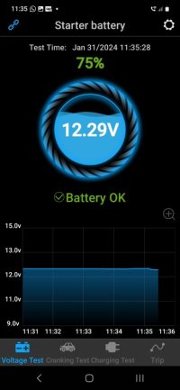

Scanned with Carista and a few codes coming up, pics and a pic of the battery sensor showing good health and a video of the issue are attached.
Obviously two codes stand out, the battery regulator 02256 and low voltage 27277.
If theres no real, related faults to the non start problem, the the chance is higher that the fault lies with something that isnt monitored by a control unit.
Pesonally, given the symptoms, i'd be checking voltages to the starter and if they are ok - removing and bench testing the starter.
