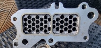

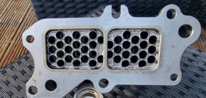

I used oven cleaner. Soaked until I could scrub the deposits off then rinsed thoroughly.
I needed to essentially drill out the tubes as some were blocked completely. However, once the cleaning fluid could flow everywhere it made short work of the carbon.

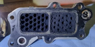

EGR Time
@Bear
Just so we know what to look forward to, how old/mileage was your van when you took that pic?
Do you mostly do short journeys?
Do you use the classy fuel with the additive?
Did the pipes have a gasket?
Thanks - it is just so I can get my nightmares correct tonight.
@Bear
Most of that info is in the post that I linked to. That was the van's second EGR but....
...how old/mileage was your van when you took that pic
- its a 2016 euro 5, 140, so about 8 1/2 years old and 150000 but I estimate 60 - 70000 since it was fitted (i'm sure I had a receipt for the first replacement at around 80000 miles)
- No, a mixture really. 5 mile occasional commute, 20 - 50 mile weekend trips, camping >100 miles and I used to tow a 2100 kg trailer now and then.
- No. I'm firmly on the fence with such things.
- they do but I didn't carry out the replacement. I kept my old EGR to see if I could clean it up and keep it as a spare.
