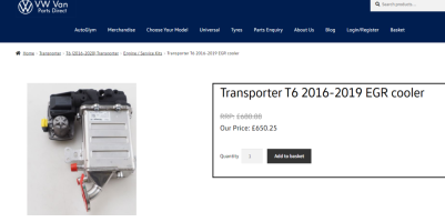

looks like this one,
so the EGR plug is unplugged. . . . but no warning lights on dash? - new van to you?
The EGR may have been mapped out? - assuming you would get an orange dash light for a faulty EGR if not.
OK, I was just wondering if it was a CFCA with a Tafmet kit, it isn’t.
As far as I’m aware there is no way to disable the EGR without a software modification and possibly some EGR pipe blanking plates as the valve will almost certainly be leaking.
