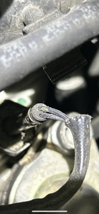

Upon mooching around with a bore scope I’ve found oily discharge from the front EGR pipe where it goes back into the inlet (this was changed about 3 years ago). And the EGR temp sensor 2 looks to me although hard to see like it has become corroded where it leaves the shaft of the sensor.
So 2 things I’m hoping you experts might be able to help with;
Does anyone have the part number for both a new EGR front pipe and the Temp sensor 2 (plugs directly into the forward most part of the EGR cooler just below the front pipe) in the workshop manual it’s identified as 21 (below). 2017 CXEB. Any help very much appreciated.
2nd, I’m really reluctant to start replacing costly Adblue parts in blind hope, is there any series of tests / checks I can do to try to pinpoint why I’m getting this error? IMG_1145.png

So, yesterday I got bored so I whipped off the front EGR pipe at the EGR cooler end, with that off I could clearly see the soot was moist, not the dried / caked on soot I saw when I changed the pipe 2 years ago. I used my bore scope and sent it down into the cooler and what should I find? Pooling coolant!… I ran a VCDS scan and nothing different to the Carista scrape. I did notice though that Reductant level and miles all read true. Did a DPF scan and again that all looks ok. So, EGR cooler being done a week Monday so fingers crossed that will solve the spurious errors relating to adblue. At least with that replaced I can start faulting the adblue without being skewed by the EGR cooler.
UPDATE, so after confirming cylinder pressure good and the obvious puddle inside the EGR cooler I had the EGR / cooler changed out, beast of a job especially on the DSG model as starter needs to come out. Anyways, Adblue issue - gone, coolant loss - stopped, throttle response - like night and day. I do plenty of miles so no doubt if Adblue issue returns It’ll be sooner rather than later. Looks like all the values for NOX and Adblue were thrown out by the coolant being where it shouldn’t. Worth noting if you have a similar issue. Also Checking the EGR was simple and took 10 mins with a cheap bore scope. Fingers crossed now
