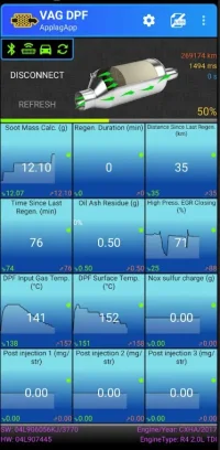

Hi, didnt have time today to do a full log, but I snapshotted VAG DPF. Think I'm right in thinking pressure dif is a bit high, if that means anything..

Got the dreaded DPF warning light again. Plugged it in and monitored the live data to see what is going on.
When driving (even at 2000-3000 revs) the DPF does not get hot enough to regen for the normal duration. Active regen It sits around 480c-530c and ticks off the soot very very slowly, therefore giving a regen duration fault.
HOWEVER I had always noticed that if I park up while active regen is going and leave the engine on, the light will eventually clear. Looking at the data it seems that when I park up the engine temps shoot up to the required 600c-670c and the soot burns off quick sharp.
