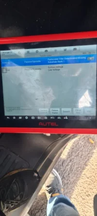

I have a T6 and few weeks ago a fault P226 come car is running pretty well I have only 61k and I don't know how to deal with this please someone can help me ?

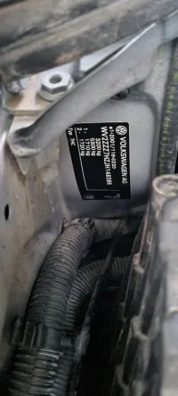

8k miles I replaced the engine like few weeks I'm driving mostly on motorway car have totally 61k miles is dsg gearbox 2018 2liter I'm not a engenier I don't know exactly the engine code
Vehicle Identification No. WV2ZZZ7HZJH148386
Model caravelle TR
Date of production. 23.03.2018
Year. 2018
Sales type. SGJTF7
Engine Code. CXFA
Transmission Code. SDJ
Axle drive. 7A
Equipment. DM
Roof color. X3
Exterior color / Paint Code. X3 / R7H
I guess it's saying the DPF is not performing. Did you clean it out or remove the core when the engine was changed?
Looks like it's broken apart inside; maybe it overpressured due to lack of regen and blew out... new DPF time..
