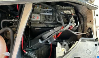

How old is the starter battery?
AGM battery life is normally 5years. Your van is 2017. So original battery?
Post a few pics of the battery.
looks like the original 70A MOL battery to me,
might be worth getting it tested.
get your own tester - Amazon.co.uk : 12v battery tester
or take it to Halfords et for a test.
good to see the negs are on a chassis point and not on the battery Neg post
