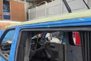

@AJCConversions with the carpets round the windows, thats the route i want to take, it looks soooo much neater! Although I did read (or saw a video) somewhere that said you end up with 2 panel skins when cutting some of the windows and its easier to fit the larger rubber trim over both skins? Surely you dont just carpet over the gap of the panels or am i over thinking it?
Looks like that pic was just before offering the windows up?

The carpet will go over the gap of the two skins and no problem. Don't over think it lol
