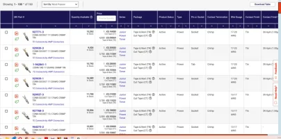

Connector reference
Thanks @oldiebut goodie
Looking at the 2nd and 3rd up from the bottom, 929937 and 927768 (and possibly the last one too) - do you know what the difference is ? Everything (other than price) looks the same ?
There are pages more of them!

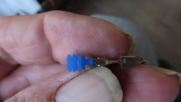

927768 is pre-shaped for the seal to be inserted and crimped in at the same time as the terminal is crimped.
They are all going to be the same terminal with differences such as plating, wire size, retention method ( some are retained by 2 spring tabs, some by single tab, some by 1 tab and a cut-out, some just a cut-out )

So, am I correct in saying the part numbers above are for the connector AND the size of wire that’s provided with it?
Correct. The quoted part numbers were repair wires consisting of 2 crimp connectors and a wire
In part numbers each symbol denotes a difference - thus e.g "000 979 133" is a different part than "000 979 133 E"
