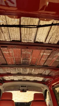

Hi, I have just taken down the roof to fit a new halo one. There was some condensation patches. Any thoughts?
There is black foam stuck to roof (sound deadening?). I am thinking of taking this off. Doing dodo strips and then sticking back over. Do you think this is necessary and would you also add some insulation?
Many thanks.
Ok, so have other jobs to be going on with (never ending..), but will be coming back to this and hoping some can advise to remove the foam or leave it?
I was going to remove, put dodo mat and then reapply the foam insulation/deadening and then if room add further insulation.
When I did mine I stripped it down to bare metal, then silent coat, followed by dodo liner
Seems to keep warmth in and has definitely kept noise down
