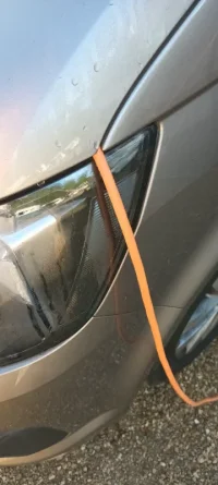

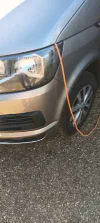

@Sim667 My EHU is under my bonnet and the cable a 2.5mm the bigger EHU cable fits easily though bottom passengers side with the bonnet closed
I don't know if the alarm works properly with the bonnet open someone else will advise if so soon
I'll get a picture later
I do this too, either that gap near headlight or you can route wires out the top past the bonnet hinge without trapping them.
