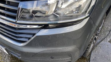

Just noticed the exact same issue on both headlights. I was about to book it in anyway as the tailgate actuator has started playing up and half’s opens the tailgate all the time. Van centre Manchester said they do an inspection before confirming it’s covered under warranty!! With two faults like that I’d have thought they should be able to say if there covered75D4FC8B-0B69-4AD7-A667-697C272C4ECE.jpeg
