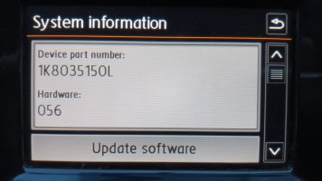

Hi I have a small problem with my T6 Transporter panel van basic radio it has no blue tooth. I bought the van last June but have never got the BT to connect with my phone.
Every time I try it says no BT device. I have attached a few photo's but wondered if the radio has the BT module in the head unit or outside in the dash or under seat?
The van has a swivel passenger seat and wonder if that has caused the problem because I see some reference to BT being located under passenger seat?
If any of you wonderful people have any ideas that would be great?

Yeah I have tried both of them and using menu to do factory reset. If someone can tell me where the BT module is, and if it is part of the head unit I would just replace it. There are loads on ebay etc for sale. It is just so frustrating with no hands free.
There’s a thread on here where someone said the dealer had deactivated Bluetooth on their Comp Media headunit.
You can check it yourself through the FEC/SWaP codes:
You’re looking for ‘0050000’ shown as an installed code. If it isn’t, Bluetooth isn’t active.

If I hold Setup button for 5/10 sec all I get is the images at the top of this thread, No FEC / SWaP codes or menu to access the codes like the videos. It is a VW basic radio no Sat Nav etc but at a loss with this one.
