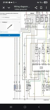

The car is actually in the workshop today. after 7 rounds of various troubleshooting and component replacements, I got fed up. sat down to carefully read all the invoices from VW. could not find anywhere that they had actually changed the wiring harness between glow plug no.3 and the ECU. Frustrating... it was step 2 on the VW troubleshooting chart. anyway, they're replacing the wire today, hopefully it'll be fine after that. Attached are some pictures that may help.

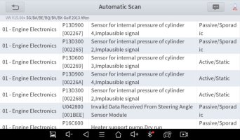

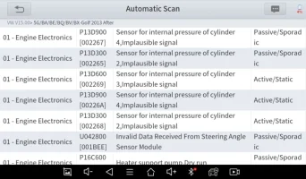

Hi guys. I have a Golf TDI 2016 that's showing a similar problem but I've been reading your posts to see how to fix it. Have you suffered a loss of performance because of this issue or is it just annoying to constantly have the check engine light showing? It seems like it's a lot of trouble to get it fixed and hard to isolate the problem. Mine is showing problems with the sensor in cylinders 2, 3, and 4 which makes me think it's something electrical rather than a problem with each individual sensor. But, if the motor runs beautifully without any obvious issues, is it worth fixing? I bought the car second hand and it's out of warranty.
