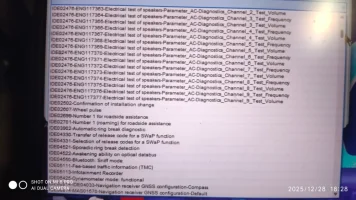

Thank you very much for the support, even if you are not an expert it doesn't matter, yes I performed the entire update, it turned off and on I think a couple of times after uploading the files, then in the end this screen appeared, but even by forcing the shutdown with the button when it turns back on the photo writing reappears and I can select the items on the list but the arrow at the top right doesn't let me go back.
Good evening everyone, I urgently need help, I also had the problem of the clock at 00:00, I downloaded the file and uploaded the update to the infotainment, but when it finished, this image appeared and I don't know what to do...
I had an identical issue happen to me a few months back. It turned out there was a dead spot on the touch screen where the back button is. I had to order a new digitiser and install that. Required taking the unit apart to do so but I was able to complete the update there after.

Thanks Derek, the procedure was clear, but thanks for taking the time to reply. The problem finally occurred, but as suggested, I strongly suspect the problem, as suggested, is due to the touchscreen, which I hadn't realized wasn't working in the upper right corner, and which therefore prevents me from exiting at the end of the procedure. I ordered a replacement part and will replace it. Hopefully that's the solution. I'll let you know. Thanks again. Just to add some more information, hoping it'll be useful to someone else. The first link has the username "guest" and the password "guest."
After replacing the digitizer, I solved the problem, I managed to complete the procedure, I then solved the error with vcds, now the time is correct and everything seems to work, thanks again for the help, to anyone interested in doing so I suggest checking the status of the touchscreen before proceeding.👍
