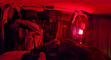

we`ve been using a RED USB lamp left on overnight..
