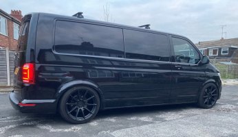

I've had B14's on for 4 and half years and been more than happy with them . After one of my front springs broke I decided I'd try a few things to get a little lower .First was machined top mounts with h&r anti roll bars . The van ended up looking a bit nose heavy so I went for the rear adjuster deletes to level things up .
After driving it was terrible, the front tires started to rub on the liners and the back bounced over speed humps and the whole van rattled. Bugger , I've ruined my van, I was thinking . So with the help of the forum and youtube we've done the following
Removed the top screw on front wheel liner and pushed them over the tab which has thankfully sorted the rubbing .
Put powerflex adjustable bushing in the rear and it now drives straight (it never has )
Cut rear bump stops down which has improved the bouncing but it still feels a bit harsh on speed bumps and pot holes . We didn't put the rubber bit back in which might be causing the harshness over pot holes.
So that's where I'm at now . Looks great but doesn't drive great. I'm thinking I might try some so-lows. Can anyone comment on if So lows on there highest settings will be lower than the second pic. I don't want to go any lower than this really as its a work van and does kind of have to be practical .
Top pic was B14 on the lowest at the back and 10mm left on the front
Bottom is with machined top mounts and rear adjuster delete
