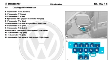

You could introduce 12v to the pump supply cables in the connector block under the seat?
Reactions: DXX
That’s the diagram I’ve been searching for for the last 30 min, I haven’t found it yet.
Seems like a cheap and easy solution.

it doesn't look like the fuel pump wires goes via the seat base connection point?
