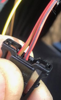

Last week, I removed part of the rear headlining in my 2021 T6.1 converted transporter, in order to wire in a reversing camera (now working!).
I came across these two unused connectors coming out the loom, on the left, close to the split where one bundle runs down to the left tail-light.
Do you have any idea what they may have been intended for? I did read somewhere on the forum here, someone saying that there are no spare/redundant cables or wires, that every van is built and there are no unused circuits . . . Is that so?
I'm quite keen to find out what these are and where they go . . . any ideas?
Plugs for interior lights, I’m guessing you have after market lights or some form of alternative fitted ?
Are you stalking me, Pauly ?! ;) Damn, that was quick!
I guess that's very possible as my converted van has LEDs all round.
Can you suggest which wiring diagram I may see these connectors in?
Thank you.
Thanks Pauly,
I found them in 03 Interior Lights_Final.pdf
