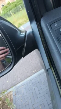

Whilst driving backwards my wing mirror came in contact with some branches. I noticed that a small plastic part has broken off. This resulted in a gap between mirror and car. It is also possible now to bend the mirror forward more easily. Who knows what has broken off and how I can fix it? Thanks for your assistance!
