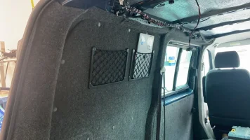

Been doing the boring but necessary bits the last couple of days, final layer of insulation (I wasn’t going to do a third layer, but then decided that it would be stupid not to whilst I have all the panels off! And a 110Ah leisure battery setup with 240v hook up...
Managed to squeeze the battery and CTEK under the drivers seat, with an inverter under the passenger seat!
Everything else is in the rear corner of the van and will be under the bed platform, so safe from damage and not visible, whilst still being accessible!
Got the roof panels back on (that was a mission on my own!) didn’t realise I’d need longer clips for joining strips, so waiting for them to arrive now!
Ill be honest, wiring etc is pretty high up on my list of jobs I don’t like.... I’m capable of doing it, I just don’t like doing it! :think smile bounce:
Also put some storage nets on the rear panels (will be both sides) just to chuck those odds and sod!
Hoping to finish the wiring tomorrow, so I can reassemble the interior. Then I will strip and rout the edges of the panels where necessary, seal them with osmo oil, then it will finally be time for final assembly in the van!!!
:mexican wave:
