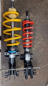

This is the reason , shock travel is a vital element of comfort , The kit on the right claims 50 to 80 mm the other kit claims 50 to 90 mm as you can see the strut is too long it will bottom out easier , this limits suspension movement and performance . The A R B bracket is also not in the best place and this limits the ARB performance ,
Hard to be 100% sure from the pic on an angle, and without them both wound all the way down but at first glance it would appear the H&R would actually drop about 10mm lower than the NSL kit?
