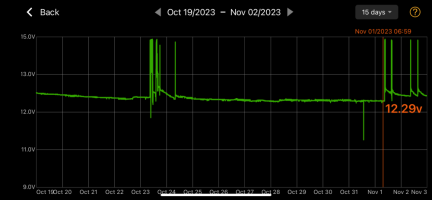

So this is the starter with BM 15 days and 1 day . Gradually drops off. The leisure battery cable goes in through the upper front left then down under the carpet to Victron 30/30 dc charger . However the isolation switch in the photo has been off for a while, as the 360w solar panel has been maintaining the leisure battery.(just turned it back on on). So my thoughts I assume is either poor voltage settings in ecu, bad battery, bad alternator, or short somewhere. All assumptions, cheers
looks like its not dropping below 12.00v, so that's good,
have you cot the previous 15days plot too? - to get a 30day plot?
..also i see you mains charger is bridging the NEG battery shunt, which means the van is not seeing the charge going into the battery,
you should move the black croc clamp to the light bracket bolt, or chassis, or engine block.
Can do, and didnt realise the issue with going to the terminal. will go connect it to the engine block or alike,an d grab a 30day screen shot

15 days is max.. adjusted date though, but shows the drop off once again from charging it
