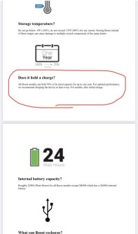

Thanks for that - Jump packs they're called then
But is there any that can be left plugged into the cigarette lighter or do they have to go over battery terminals?
I'm away for six weeks at a time so rather long at this time of year leaving the van. Solar not too good at this time of year in Scotland.

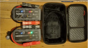

VW Assist got the van up and running in minutes using a Noco jump pack. I took a photo with a view to getting one of my own if the battery continues to behave like this. He made a point of saying to get at least the GB70 to have sufficient power for the van.
Maybe a silly question but how long does a Noco GB70 actually hold a charge for? I'm wondering whether it would start the car after sitting in the boot for 4-5 weeks in an airport car park.
