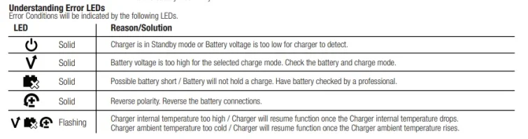

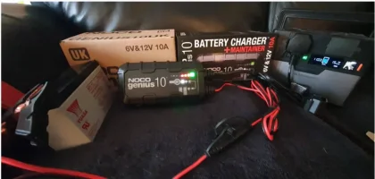

My Noco Genius 10 failed yesterday, I went to see if it had finished topping up my starter battery and all the lights were flashing on it and it seemed to be quite hot. I left it overnight, but plugging it back in this morning (not connected to the battery) but it is still doing the same. Disappointing as I've only used it a few times.

was it just connected to the starter battery? (and body ground?)
what lights are flashing? ( all like bellow . . . too hot or too cold?)

From the manual I assume it overheated and has not recovered from that mode.
Will try force mode.
was connected to the +ve and chassis.
no difference, everything flashing and squeeking.
kuput then . . . warranty / retailer swap.?
