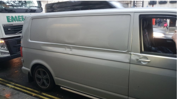

Hi, after a week of ownership, only 500 miles on the van, some dope leaves his handbrake off and his van rolls into mine.
The question I have is has anyone had an Ascot grey van painted or repaired and actually had a good colour match?
I imagine they will paint the whole side of the van?
I’m having a dent specialist look at it today so to avoid paint but I think it’s may be too far gone for this.¯\_(ツ)_/¯
Absolutely gutted!!!

Ok, so the van came back today. I rejected it!!!
Paint match was perfect, no issue.
However there was a couple of pinholes in some filler work, some crap in the paint, they had chipped the edge of the door and touched it up with a brush, plus there was 2 fresh paint chips on the fresh paint!
I’m not being harsh am I?
It’s a brand new van, I would expect it to come back perfect surely?!

That would never have straightened out without a bit of a crease so some filler is inevitable. However, I hope they pushed/pulled the dent out as much as possible? Are you able to see the inside of the damaged panel? It would have been pretty gash not too but...
That's a fair point about looking inside. As it's been repaired they will have most likely used a spotter to pull the dent which will leave little burn marks on the inside which more than likely won't have been treated and eventually rust. It will never look like an oil painting inside, but should be definitely cleaned up and painted.
I know it's easy to criticise the workmanship but if it's gone to a big repair shop there will be bugger all time on that job about 22hrs all in (15 panel, 6 paint and 1 strip n fit). Which is never enough time to do the job properly. Ultimately the customer suffers and the workers get a bad name, but the insurance companies are happy because they have saved a few quid.
I know it’s a shame, I knew there would be filler, but I don’t expect to see pin holes. I did the classic tap test and if I’m honest I could barely tell where the filler was, so there can’t be buckets of it in there. The lines are all good also.
