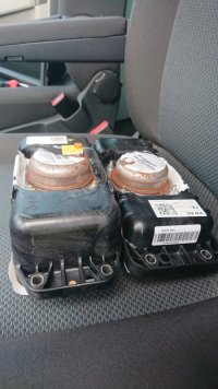

Posting the part numbers might be helpful to others…Thought it was worth posting this.
You can see the difference in sizes between the single and double passenger airbag.
The swap is straightforward and it's definitely peace of mind when converting from a single to a twin seat up front.
I managed to track down a dual passenger bag last week. Swapping it out was easy enough...glove box out and passenger storage shelf then 4 torx bolts.Posting the part numbers might be helpful to others…
