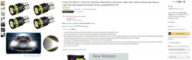

and with a set of these LED w5w bulbs . . . . . very nice.

ironically i ordered 2 different sets of w5w LEDS, and fitted the above as they arrived first . . . .
but the second lot arrived today . . . . and look stickingly similar to the Factory LED bulbs that were already fitted.!
these were the LED that i removed from the existing unit . . . . the glass ones were supplied with the new unit . . . . .
and these are the other ones that arrived today . . . . .
now the thing is that one of the factory LEDs had started to flicker intermittently . . . which was annoying...
so out of there so far id recommend the ones i listed first as above . . . .
