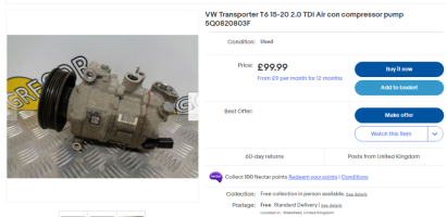

Well it's solved eventually. I'm going to strip the compressor down but closer inspection revealed a partial seizure of the compressor. EBay to the rescue after several different compressors not fitting and tps wanting a ransom for a new one.
