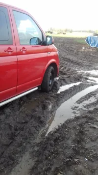

I would have liked a diff lock on mine, but to suggest that it's not worth having a 4Motion without a diff lock is not a view that makes any sense to me. I drive on muddy fields regularly, often with a few hundred Kg's in the back, where a 2wd T6 would be asking Mr John Deere for a tow.
A 4Motion with M+S tyres will go where a 2wd with the same tyres won't, diff lock or not.

I don't use my van for any extreme off roading, I can use tractors for that. In the Alps they can justify using proper winter tyres, I can't be arsed changing tyres twice a year, but a T6 4Motion with winter tyres all round will still go further in the snow than a 2WD with winter tyres.
