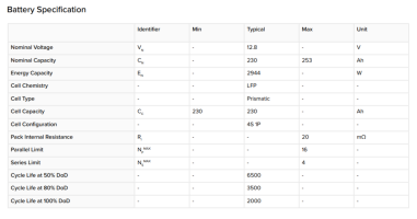

230Ah @ 12.8v - 2944Wh,
Low Temp Charge Protection,
Low Voltage Cell protection,
built in Pre-Charge circuit,
Mechanical Sleep Button,
10year warranty,

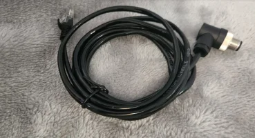

we also have the Victron GX CAN cable, which we will use to connect the battery to the Victron Cerbo GX directly,. . .
doing away with the need of a separate Victron shunt,
making a simpler and cheaper installation.

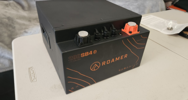

the battery itself follows the previous seatbase design of the Gen2 and Gen3 battery's,
handles on the side, terminals on the top front.
this time we also have a ON/OFF push switch next to the POS terminal - a very nice addition.

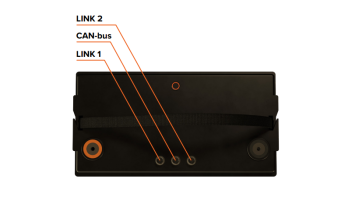

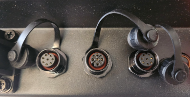

we also have the 5 & Pin sockets for the link cables.
the 8Pin is for data-link for multiple batteries,
and the 5Pin is for the Victron CAN bus link.

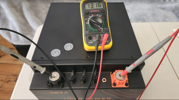

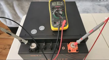

getting the battery ready. . . you can see 9.8v on the terminal with the battery OFF in Sleep mode.
pressing the Power button brings the unit to life,
showing nice Orange glow,
and 13.6v at the terminals. . .
very nice,

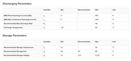

this is for charging only. - you can DISCHARGE the battery down to -20.0c !!
Victron GX Integration:
A) Ensure you have plugged into a BMS-Can port, and that the CAN Terminator is also fitted in the adjacent port on the GX device.
If you have a Cerbo GX MK2, Cerbo-S GXor Ekrano GX, you will need to change the VE.CAN Port function:
1. Go to settings on the GX Device
2. Scroll down to Services and select it
3. Select VE.CAN Port
4. Select CAN-bus Profile
5. Select CAN-bus BMS LV (500 kbit/s)
