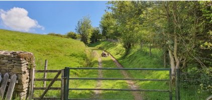

Thanks. That's good to know. For reference on incline here a summer pic. It just gets very slick in winter.

Your van looks lowered which might not be helpful if the track has a higher centre in places.
Yep it's low but the track is level, no grounding issue. I'll go all season for the next batch of tyres (which won't be long with the rate it's munching them!) So I'll have to see how brave I'm feeling this time round. From what I gather chains are as good as all terrain tyres for mud.
