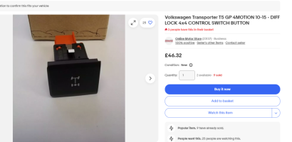

my T5.1 DSG 4motion had a DIFF LOCK button .
