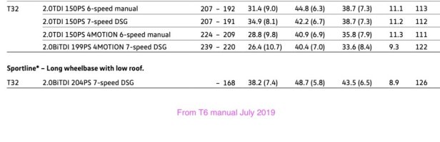

  • Why is the quoted MPG so much lower on the 199 compare to 204? (see photo from T6 brochure).

I think the fuel economy on the 199 in the brochure is lower because it’s for 4motion as opposed to 2wheel drive for the 204
