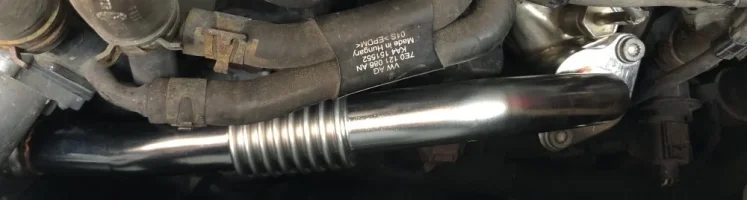

Currently considering blanking and coding out EGR but seems the jury's out! With 130,000 miles on the van we're gonna hold onto it so if the process won't cause any long- term damage it may be the way ahead. Like many on here it seems, I too blanked off the egr pipe (with a irb developments kit, so shiny!) on a defender td5 in years past with good results, although it had no DPF and was not by any means as modern an engine.
Didn't cancel the code, van into VW tomorrow so we'll see what they say. At least it looks like blocked EGR won't do any damage in the meantime?

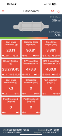

What sort of regen frequency should I be seeing with a 204 with a new dpf running on premium diesel?
Thanks
I’ve already got the Carista dongle and app and I’ve been keeping an eye on it, it’s at 17g now after 175km.
It always used to start regen at 24g before so assume it’ll still do that now?
