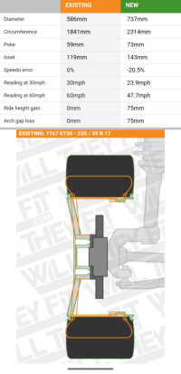

Hi, looks fantastic. Just wondering if your van is on standard suspension? Or lowered?
Hey mate, thanks for the compliments. The suspension has been changed to STX coilovers but set pretty much to the original ride height, so not lowered. It may look lowered due to the fact of the larger tyres which fill the 'arch gap'. ;)
Brilliant. Looks great.
I've been looking for a while now.
Hard to get the ballance of arches being filled, but still nice ride height and comfort. I think you have sussed this for me.
Well done and thanks for sharing
