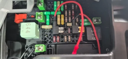

I turned off the ignition last night just as the wipers operated. Today the wipers and washer won't work. Any ideas? Picture of fuse board below but searching i cant see which will be the wipers. Cheers.
Well i never....with the bonnet off the latch, the wipers dont work. I can now understand why. The bonnet wasn't fastened as my mains cable goes to the socket in the engine bay...the bonnet was down but not latched.
