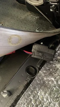

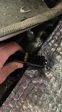

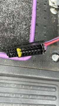

Update! Finally found the fuse. Removed passenger seat and with the aid of a photo from another vehicle of same age was able to identify cable which was attached to fuse box . This was tucked well under the flooring towards the hand brake but easily reached when you knew which cable to follow. Fuse was not blown but in fuse location 5 rather than correct position of 6. Such an easy fix after a whole week of stress over it. Hopefully the photos will help others to be able to locate their fuse box in a similar situation
