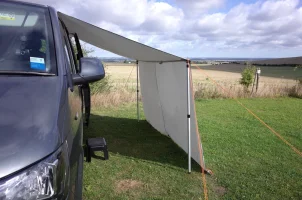

A Debus Sun Awning/Tarp is a simple and practical possibility - very easy to attach & pitch with just two poles and you can also drop the front down in bad weather to create a more enclosed set up (see photo). Or, if you want something that you can attach side & front walls when required, have a look at the Khyam Sun Canopy set up. That is also quick and easy to set up.
