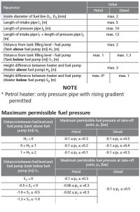

Can I add something to this thread ? I've converted a shuttle to a camper and fitted a diesel heater. Following the threads on here I have tee'd into the auxiliary heater supply to feed my heater. Everything has been fine until recently when I noticed a diesel stain where I park. Cutting a story short, it was the nasty green CDH pipe that had a very small leak. I've subsequently replaced all the pipe back up to the tee. To bleed the system I left the pipe off the heater pump and started the van - fuel came through after a couple of seconds indicating that it is a pressurised supply. Having searched and found this thread, I'm now concerned that picking up fuel from the auxiliary heater could cause problems if I ran the heater and engine together - I've not tried.
Any other shuttle owners done the same?
Mine was definitely T'd into a pressurised feed incorrectly.
Colin @ 8Ball campers Nr Hull sorted it out in about 10 mins for me
It dribbled through - not a powerful jet but certainly had some back pressure
Sounds like it is well under anything that would cause problems. You can have up to 2m of head that would give the same as you have seen.
What pressure does the pump in the tank produce? On my t5 I installed a new standpipe in the tank so the heater pump was on suction lift. On the shuttle if I've now got say 5psi positive pressure at the heater pump, is the 5psi difference in inlet pressure significant in terms of what the output pressure is from the heater pump?
If say it delivers 100psi, it's only a 5% variation, if it's 10 psi then it's 50% which is going to be a problem if I start the engine.
