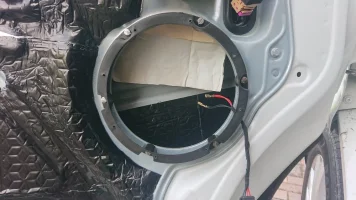

Have had my T6.1 kombi since November. In June noticed some water after I had washed my van as in the photo below - this is the front passenger. Nothing at all in the cab lining
or on the step or on the floor. Went to VW who replaced the door seal but it is still occurring. Booked in again with them but they are unsure of it's entry. I do have roof rails and suggested if we should be removing these but they said that it was the wrong place for water to collect if it was leaking from there - it should come down the A pillar and pool on the mat under the glove box - so said not to remove for now. The van had had a front speaker upgrade prior to me buying it and I don't know if something got disrupted when that was done but if so, would that take 7 months of ownership to show?
And then in the last month I have had water collect in the lower door slider groove again after a wash and also on the near side - again no water in the cab lining, windows are not obviously leaking and there is no water in the rear step. VW think that the cause of this is that the carpeting inside the van has gone too far under the rubber seals and that is causing the water to collect in the lower slider area.
Van is parked on almost level ground (driver side of van ever so slightly lower than the near side).
Could these two things be related or coincidental and what could be the cause?
Any advice would be greatly received as the failure to remedy this is getting me a bit down.
Thanks in advance.
