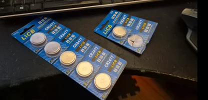

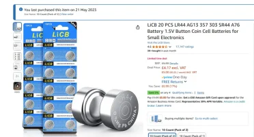

Make sure you get the proper cells CR2477T as recommended by @n10n . When I looked they were a lady Godiva each, let me know if you find them cheaper than that!
yep, same. 5 Dorra. for 10 !!!!
and it looks like i already have a 10pack. . . lol ( from 2023)
in fact here they are. . . .
just found them in the draw - result.
these were the ones i used before.
4x missing from the pack - which is 3x RUUVI`s and 1xAlarm Door contact.
which leaves me with one RUVVI with a low battery . . . all making sence now.
the problem was i lost one of the RUVVIs,. . . so had to some BT tracking to find it,
ie hotter, colder,. . . hotter, hotter - i knew it was in the shed somewhere, but where?
long story short - it was in the camping fridge from the Camperjam last year, the one that went into meltdown.
so that battery wasnt replaced last year.
anyway - stock found. looks like were all good.

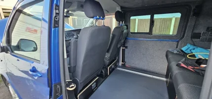

Finally all back together. Flat starter battery this morning which was a bit worrying. Seems OK now. Thanks @Dellmassive for the phone tech support. There's LOADS of settings. One thing I will say make sure you get the pin numbers off each module. I didn't and had to reverse a LOT of the way before I could get it working.
